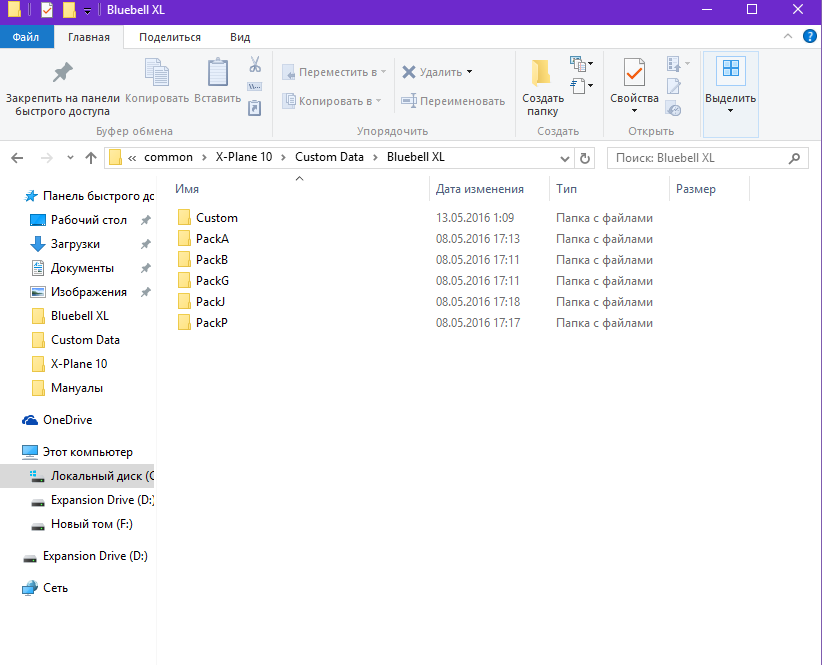

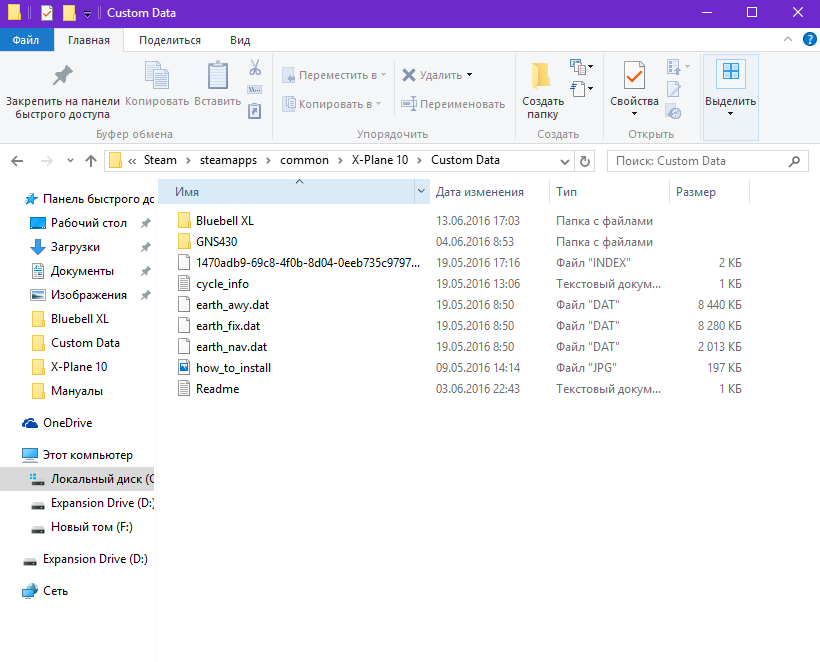

Boogie72 wrote:
Здравствуйте. Я скачал то что обведено, и установил согласно вашему скриншоту. Не работает. X-Plane закрывается.
So, I understand you "Hello. I downloaded something that circled , and installed in accordance to your screenshot . Does not work. X-Plane is closed ."
So, the file (BlueBell) get placed into the //*Custom Data Folder/ then the following folders go into the Bluebell file;
Pack; A,B,G,H,J,P, and Custom ///
That is all if you do it right you will see a read out on the log.txt if you look it will be towards the bottom of the txt.
Happy Flying,
Привет, Вот мои установки. X-Life не работает. X-Plane закрывается. У вас я вижу Pack; H ??? По вашим ссылкам его нет.
Судя по логу
XL: 0 : !!! Error: Cant read file C:\Program Files (x86)\Steam\steamapps\common\X-Plane 10\Custom Data/GNS430/navdata/airports.txt
XL: 0 : !!! Error: Cant read Ats file
не установлены (или неправильно установлены) файлы NavData

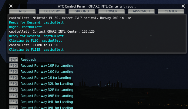

this is a screen shot of the arrival runway list at KORD and the widget showing the list of different runways you can choose from to land ...
Happy Flying,
Attachment icon Screen Shot 2016-06-12 at 9.58.09 PM.png 275.92 kb, 179 downloads since 2016-06-13
Судя по логу
Большое спасибо. Исправил файлы  NavData. Всё работает.
Удачи. С уважением. Игорь.

Thanks Brian and also for your screenshot. Attached is my screen after contacting Centre for my descent. As you can see I have been given Runway 05 for landing even though the wind was 290 deg in the ATIS and there was a runway 23 that would have suited better. Notice that there is no alternative runways for me to select. I was landing at NZAA which has one runway 23L/05R (note I disabled the 23R/05L as its not actually a runway even though the scenery I use thinks it is).
Note I am using v1.1r2 as suggested by JAR.
