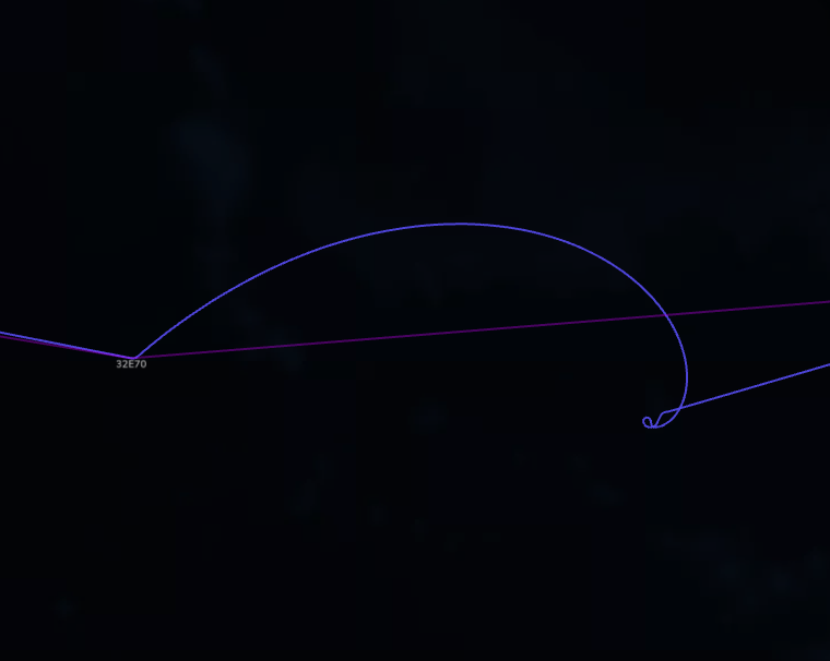

Flying RJTT-KSAN on this route: RJTT DCT UTIBO Y821 LIGNI Y816 IPROS Y830 LAPIL OTR13 SEALS DCT 35E52 DCT 34E58 DCT 33E64 DCT 32E70 DCT 31N80 DCT 33N72 DCT 34N64 DCT 35N54 DCT 35N46 DCT 34N36 DCT 33N30 DCT FICKY C1177 SXC DCT EIREE DCT KSAN
Flying PHNL-YMAV on this route: DCT CARRP A579 UPSAD DCT ABARB DCT RIKNI N774 MARLN DCT OMLAV Q15 WOL H65 RAZZI Q29 ML DCT

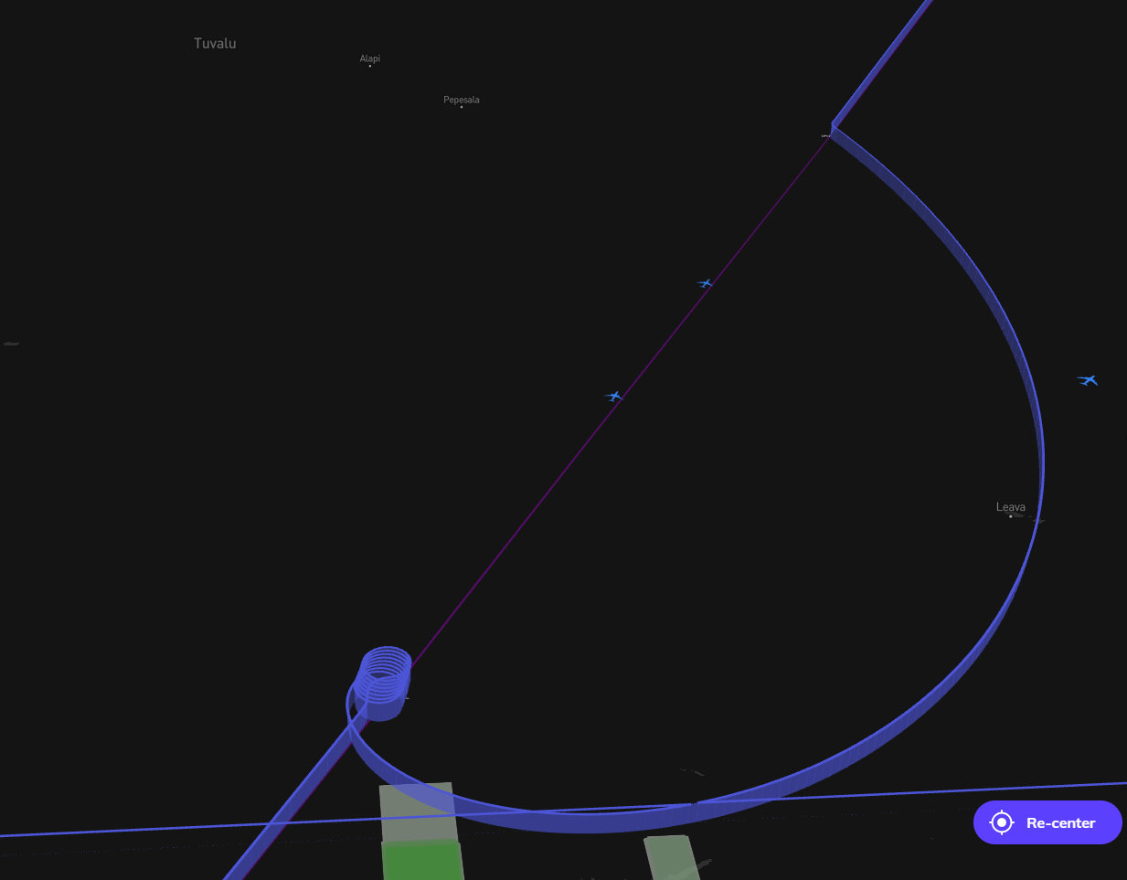

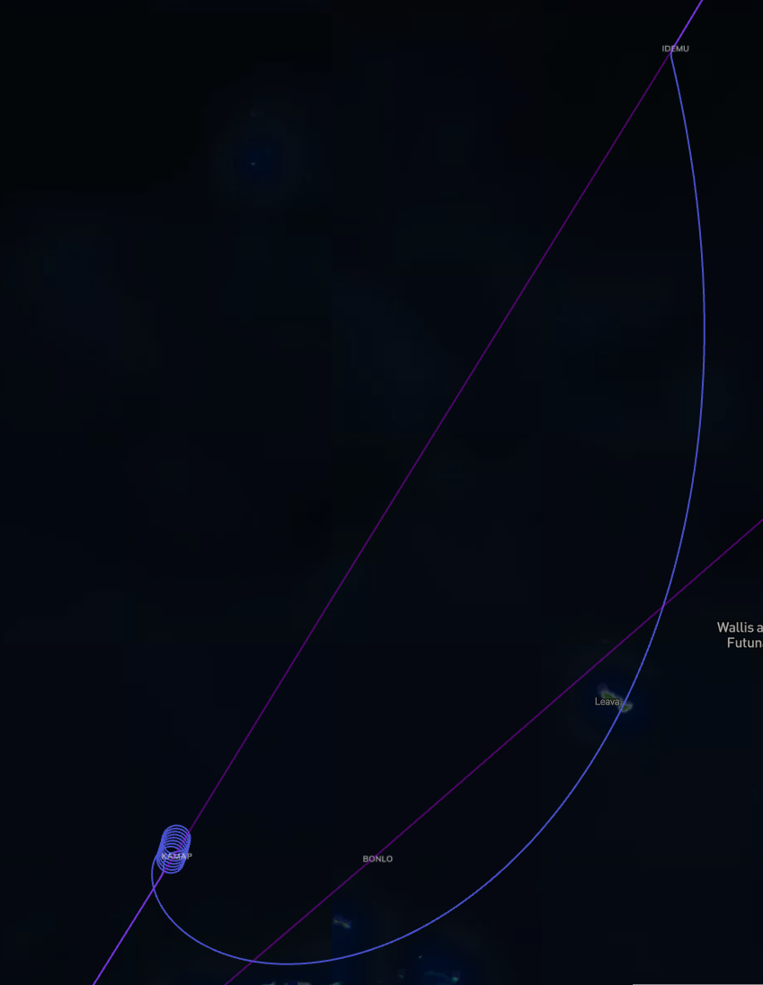

Also when flying KLAX-NFFN you can see it adds huge distances when you cross the equator
Re: XP11.50 JD330 v.4.4
Thanks for this info - will check.
After tests I see plan drawing is Ok. Look like some happen during flight. So, need to read Log.txt file saved after this flight no know details. If possible, please.
