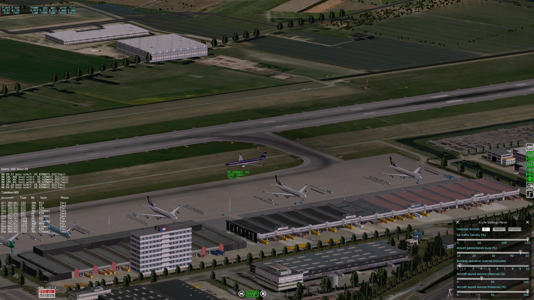

Hi Eugeny,
wrong holding short and start at EHAM on rwy 06 (starting on grass), maybe bug in x-life algorithm, because .dat file is correct, see also pic
