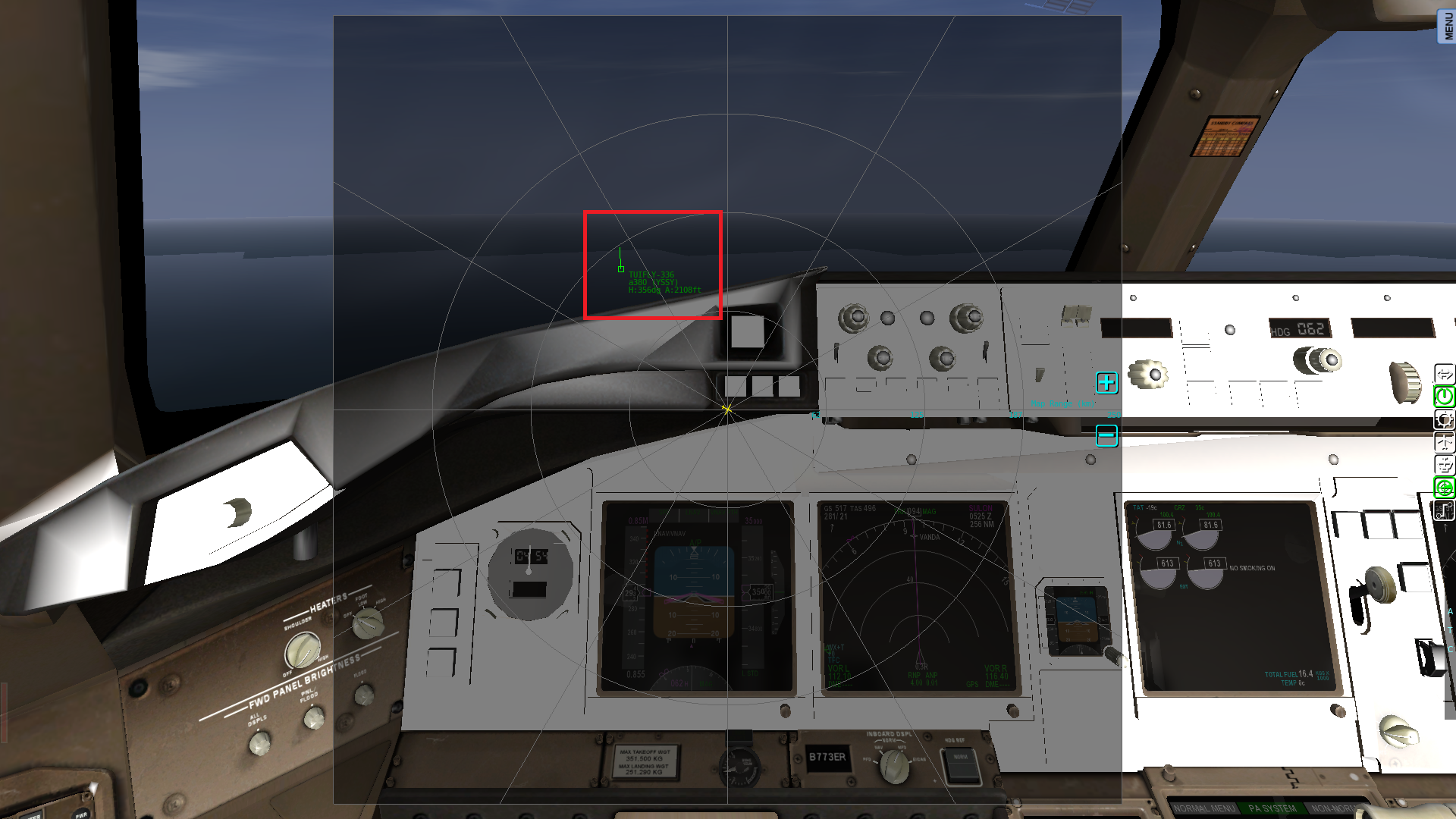

Another issue that I saw right now. I just took off from Sydney YSSY, I saw after take off that there was an airplane arriving at 2000 feet. Now that I'm at FL350 and too far away from Sydney, this aircraft that was approaching Sydney seems to start following me, and he continues at 2000 feet on the middle of ocean, saying destination as YSSY. Another issue that is unrealistic, there is an aircraft going to NZAA (I'm going to NZCH) and he is constantly changing altitude... around FL330 and FL290

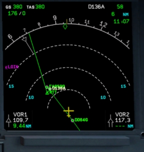

In this flight that I'm doing, the radar whos me a strange target. *LPAZ. What is that ?! And it changes of position from north to south suddently...
