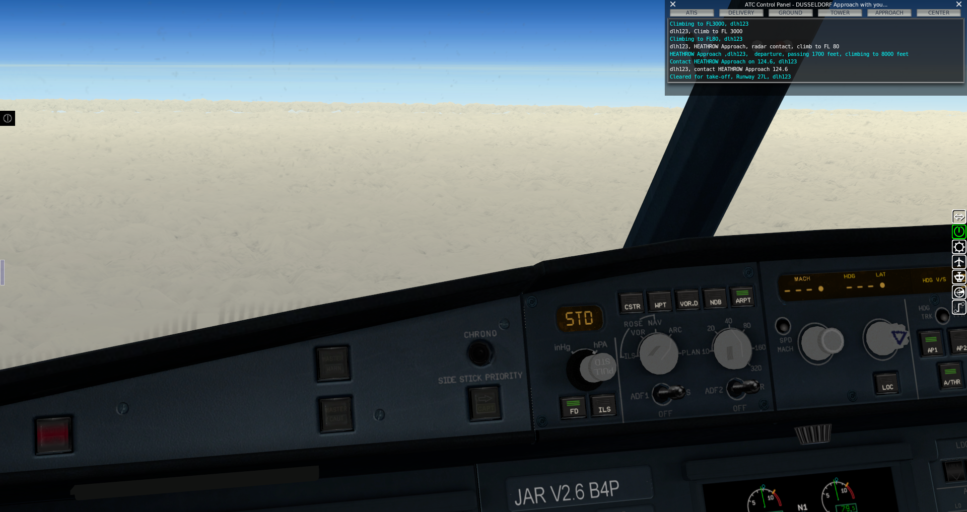

Other test with flight from egll to eddl but same problem, after last istruction from approach stop comunications.
Attach screen where i click on approach (i was to TOD) but no istruction available.
To have TOD report button you need reach CRZ FL, what was sended to ATC
I was at Cruise level from lot of time
