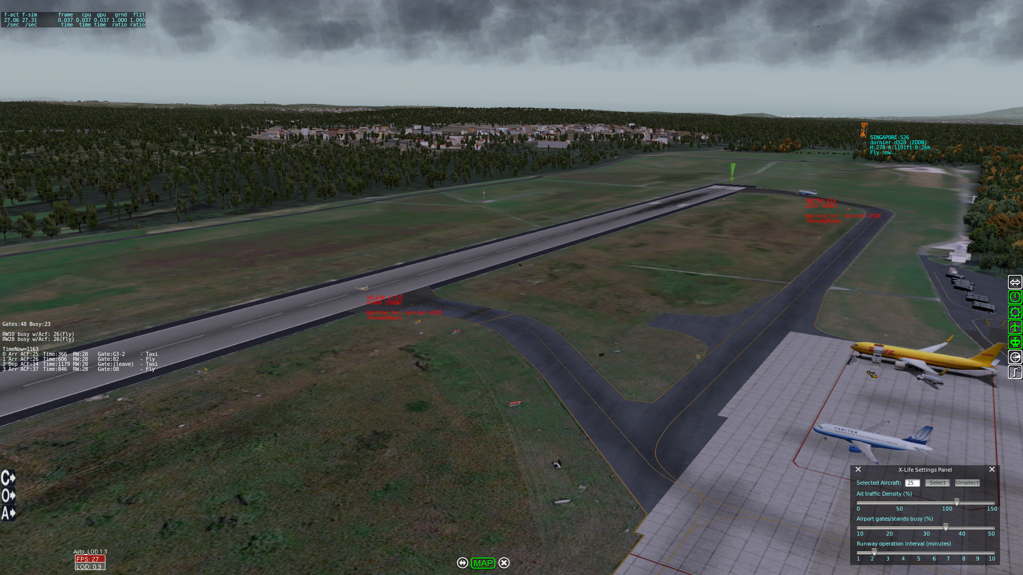

Sorry to say, but LFML is - let say - not a good designed scenery. No signed of taxi ways, parking lots are not correct etc. I have to change my take-off airport. The author was present in this thread, so please ......
http://jardesign.org/forum/img/m/1591/t/p1ae2hpsc01c3igmp1avqrko1o9e3.jpg
i'm very sorry for disappointment. Can you explain more please ?
I've just make the ATC Routes.
You have problems with scenery or with ATC routes ?
Try to explain your problem at first time. If it's too much difficult, perhaps we can meet on Skype but i'm not speak english very well.
Thank you for help me to make better work if i can. 'cause i can't touch to scenery.
Hallo sloboda, thanks for answer
I understand that it isn't your design?  To say the truth, it isn't a well designed airport. There is another scenery made by
tdg (6/2015) that seems by far to be better and with marked parking lots. If I am right you made only the taxi ways for
X-Life. Problem is that I wanted to taxi to  runway and X-Life wasn't able to guide me .
http://forums.x-plane.org/index.php?app … file=26413
Another problem was that all parking at the gates were occupied and no one of them became active (are they all dammies?)
Also after I activated X-Life one aircraft landed and because of no taxi ways, it went straight through buildings to somewhere..
Last but not least, some parking aircraft are partly with their nose in buildings..
I can only describe about problems using X-Life at this airport. I don't know how to fix it. I think that all this scenery must be refreshed especially with marking of taxi ways. It is good possible that the scenery from tdg will be the better alternative to use and prepare for X-Life (with permission from author). sorry that I cannot help beyond this remarks.
I have see the scenery of TDG. His scenery is not correct.
That's for this reason i have no choose it.
The LFML scenery was totally based on XPFR and have the same problem.
A taxiway is undergrass, i have make a correct version for the scenery of XPFR. The author have update the download link.
You understand i can't take sceneries where planes roll on the grass... If tdg want to correct, i can make a version for LFMLtdg.
Bye.
