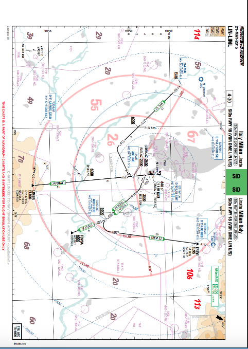

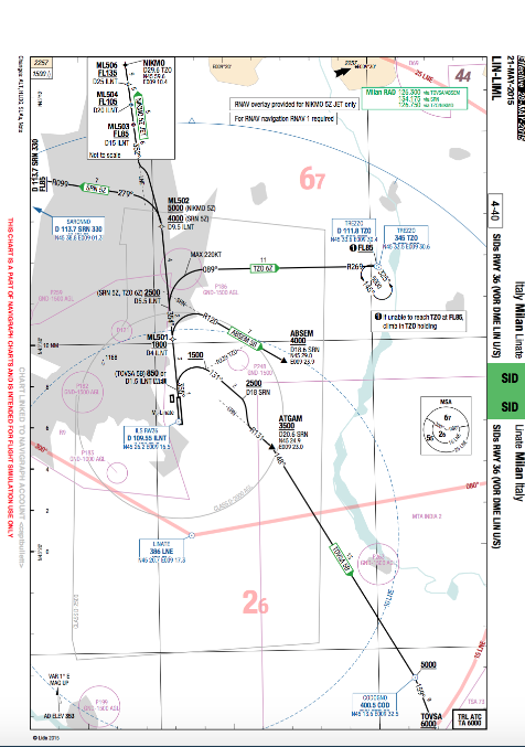

LIML (DEPART) 36 ML501 ABSEM TUVIB LOGDI EKDIR VERUN///
that is the first try, now i know what is going on you have to use the right SID and STAR for the airport and if you do not you will not get a working route when you do not use one of the first sid or star in the list then it usually will not work but pick the first sid and stars in the list and see what happens ... once i did this all was good and i had no issue with the area and the sid or FP...
always glad to help
the screen shots are SID maps of LIML so you can choose which one you want to use and which runway to use with which sid...

Attachment icon Screen Shot 2015-10-21 at 10.05.42 PM.png 184.47 kb, 189 downloads since 2015-10-21
Attachment icon Screen Shot 2015-10-21 at 10.06.04 PM.png 254.65 kb, 200 downloads since 2015-10-21
