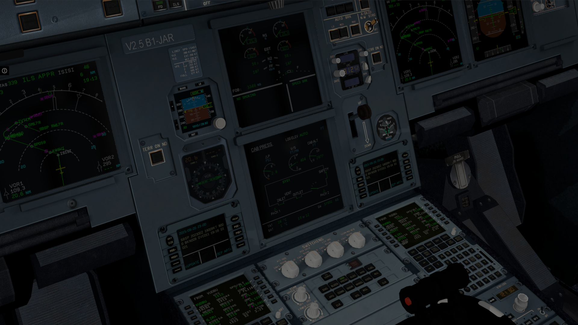

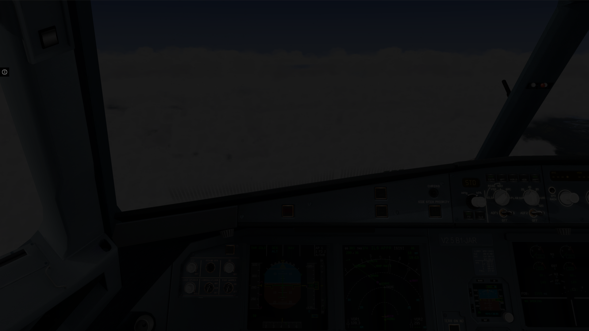

I flew my first night flight in the A320 tonight and ran into issues with instruments going dark. I'm pretty sure I had all of the lights up as high as they'd go but still no artificial horizon, etc. This flight started in daylight and ended at night. Not sure if that had anything to do with it.
Attached are log and bbox_log
I took some screenshots to demonstrate what I had. If I turned on night vision, the displays were there, they just weren't lit.
http://i.imgur.com/q4Fy7am.png
http://i.imgur.com/M9AJktY.jpg
http://i.imgur.com/HuflqsF.jpg
http://i.imgur.com/Pfy5I1n.jpg
http://i.imgur.com/7GNILjd.jpg
http://i.imgur.com/kaKy3Sn.jpg
97 (edited by captbullett 2015-09-29 01:42:12)
Re: ver 2.5 beta 1 WIN/MAC 64 bit

Thanks for the response. XSaitek panels is a plugin to interface with a hardware radio panel that I have. Panel doesn't work with A320 so I'll disable that and do some night flights to test it out.
The mention of lights looks like a scenery error related to some NYC scenery I have. It's listed twice because I started X-Plane at KJFK, then moved to KLAS, started a flight and landed at KJFK. That would have loaded the scenery twice.
I'm pretty sure that SASL error happened when selecting a SID transition when setting up my flight. I got the KJFK DEL FROM FPL message when setting up the MCDU on the ground. From previous review of that issue, I'm positive it logs that error every time that error happens. There's definitely something up with the way the MCDU interprets certain SID and STAR data. I'm on Navigraph AIRAC 1510 but have seen the error with other AIRAC data as well. I can deal with this as I was able to get the flight plan entered by using "No Transition" when selecting the SID.
