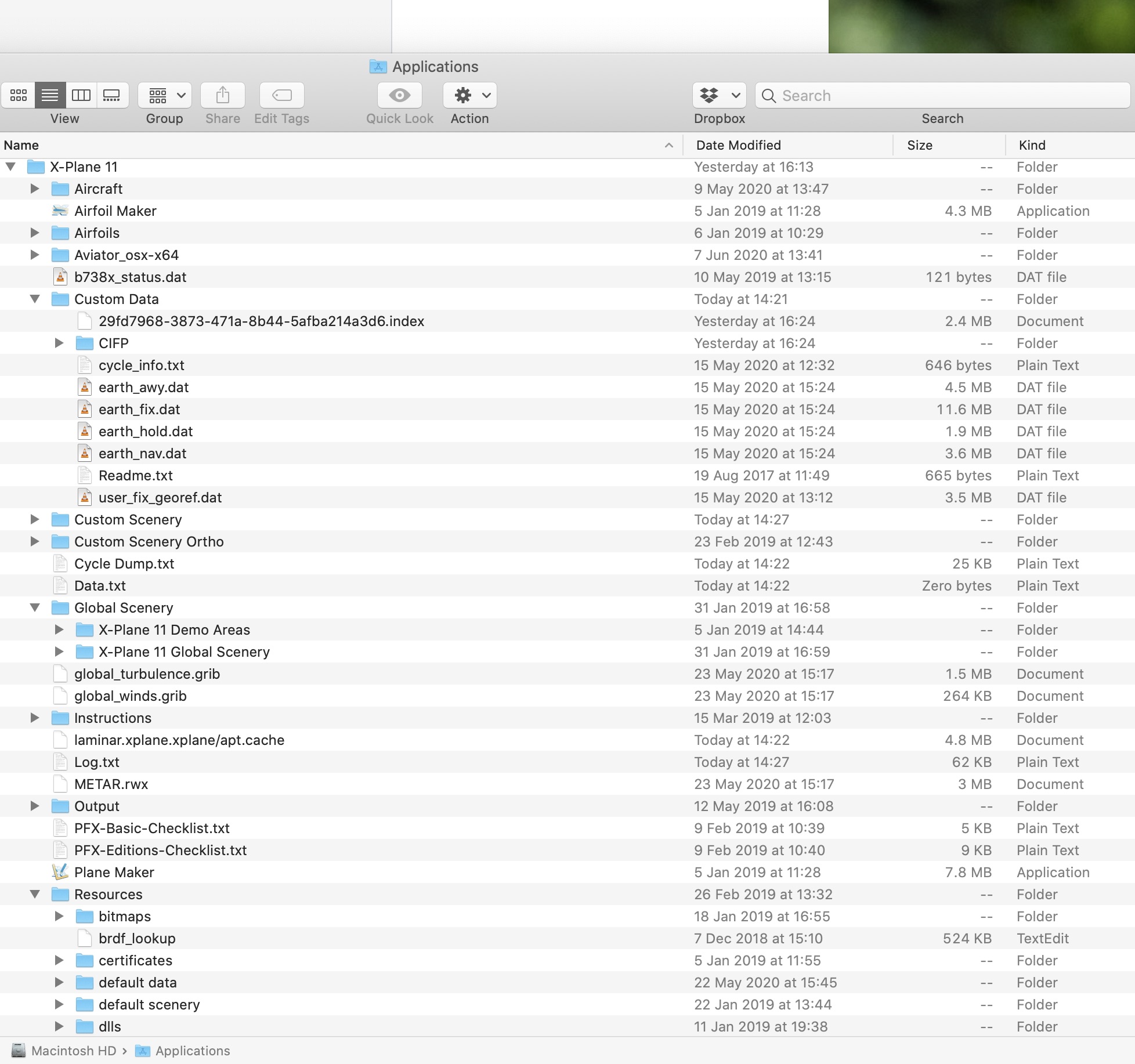

Hi There,
Firstly a fab product. I downloaded the latest MAC version.
I have now updated NAV data using FMS data manager. The new data in in my Custom Data folder. See attached screenshot.
X-plane loads and FMS on the Cessna 172 seems up to date with cycle 2006 Rev 1. I checked the status on a Boeing 737 FMS and it showed current cycle.
However, when I start x-life it says cycle 1210 is loaded.
So, an idiot question, how do I point x-life to the updated data?
Paul
Re: X-Life version v4 for X-Plane 11.50
OK sorted. Found the correct add-on and created the FMS430 folder.
morpaul wrote:
Hi There,
Paul
Two solutions :
1- You create a folder "GNS430" inside x-plane 11/custom data … and you install in it the last "Navdata" folder found on manual download page at the bottom of the page  :
X-Plane GNS430, FF757/767/777, X-Crafts Embraer E-175, Aerobask SkyView, JRollon Planes CRJ200, JARDesign A320/A330, ToLiss A319 (XP10), STMA Aircraft, Magknight 787AE - native**
2- You install manually the Navdata folder directly into "X-plane11/ressources/plugins/X-life " folder to replace the existing one (whith 1210 cycle)
a 3rd possibility is to give FMS data manager , the right way to get an automatic update :
or    X-plane11/ressources/plugins/X-life/Navdata       (to be verified) .
Happy flights
