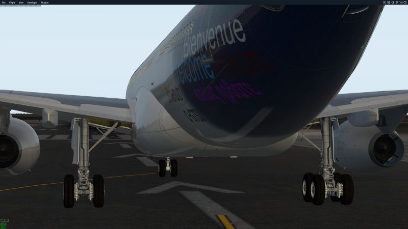

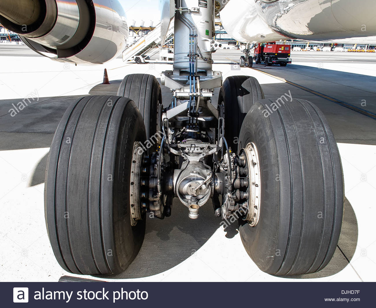

First of all, I think from an exterior point of view the A330 is pretty well made. There is one thing that needs to be improved which are the tires of the landing gear (NLG and especially MLG). They need to be wider. Spot the difference, left real life, right JAR A330
142
Re: XP11.41 JD330 v.3.3 r1, r2, r..
I can't see if pictures are attached but I will try again....
Attachment icon airbus-a330-main-landing-gear-DJHD7F.jpg 217.24 kb, 135 downloads since 2020-03-17

On Michelin Tire Datasheet
(https://www.jupitor.co.jp/pdf/michelin_aircraft.pdf)
it is
M x N - D or
M x N R D  where "R" means radial
M = overall diameter (mm or inches)
N = max section width (mm or inches)
D = rim diameter in inches
For A330 main gear wheels it is
1400 x 530  R23
54 x 21.0-23
For front gear it is
1050 x 395 R16
no dimensions in inches
under Plane Maker dimensions are in feet
semi radius and semi width
for main gear it should be
2.25 x 0.83
for front gear it should be
1.72 x 0.64
On the JarDesign model :
the front gear wheels are too big
1.81 x 0.72 instead of 1.72 x 0.64
the main gear wheels are too small
2.03 x 0.75 instead of 2.25 x 0.83
plane has to be fixed
