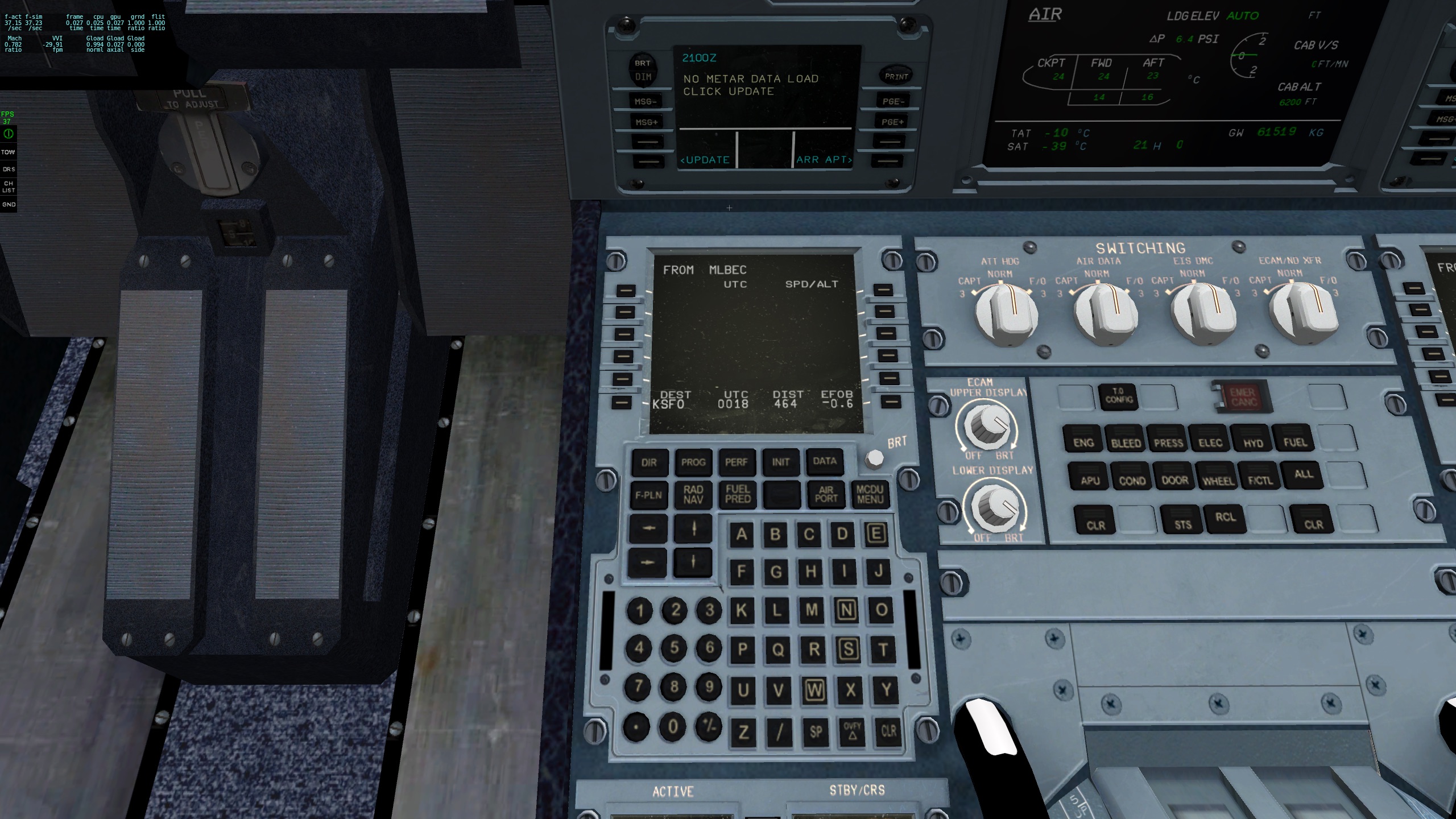

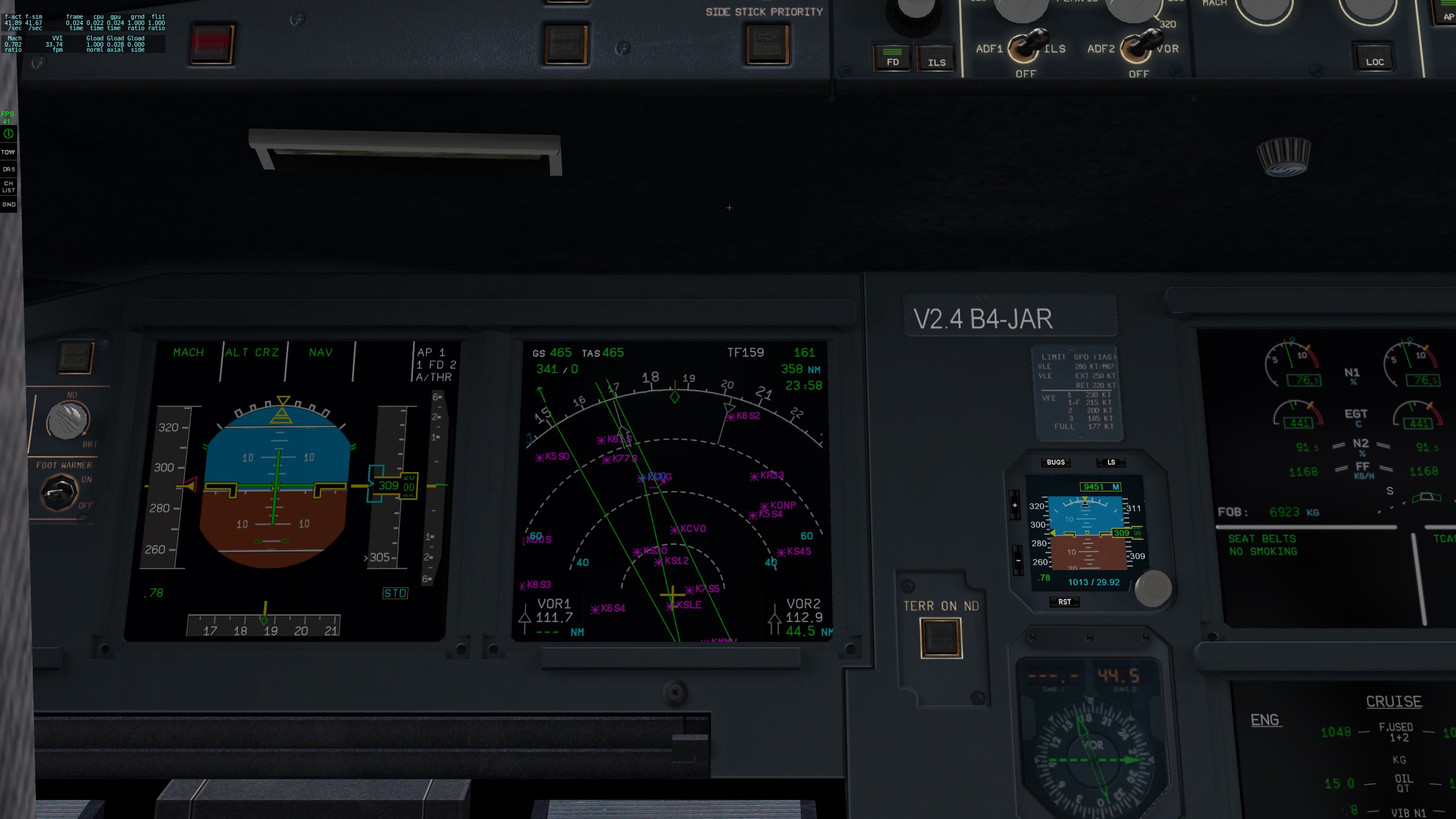

Not so lucky this time on a flight from KSEA to KSFO. On my way to MLBEC, I got all kinds of lines on the ND and the FMS turned up empty. The whole flightplan in the FMS was gone, but there were multiple routes on the ND. I chose to abort the flight. The only thing I did was trying to insert a waypoint that Flightaware mentioned as a vital part of the route.

Green Dot should show only in clean configuration
Sorry, in the last version (2.3) PFD indicate a flap retract speed (F) and slats retract speed (S).
Attached img of the real airbus.
http://jardesign.org/forum/img/m/527/t/p19mq71qgg1hl19vot42kq2phf3.jpg
