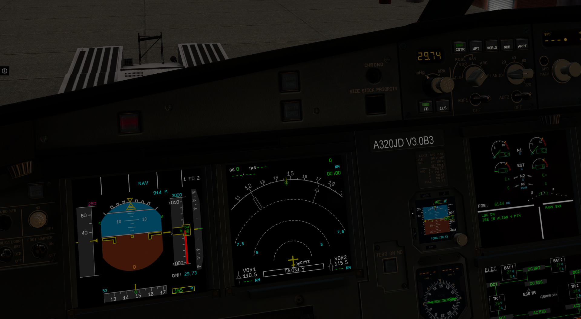

Just noticed QNH on the FMS adjustment knob is not equal to the MFD value???
