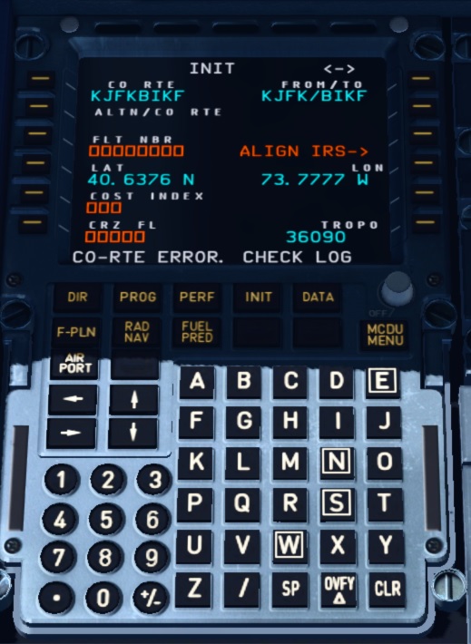

Hi!
Thanks for coming back so soon. I expected that it won't work for you smile
This what bothers me most, that no one explains how could we get this working. Currently I cannot find ANY solution to make the FMC loading flight plans and it seems there is no way to save the route you entered manually. I think this would be a very basic feature, it is all about input, nothing else. Not a rocket science and it has nothing to do with the "realness" of the plane.
Btw, the spoiler (speedbrake) problem now became permanent. After takeoff, when I try, it works, but a few hours of flying later it won't work anymore and in addition neither the managed descent is working well, the plane easily gets to overspeed sad

Hi!

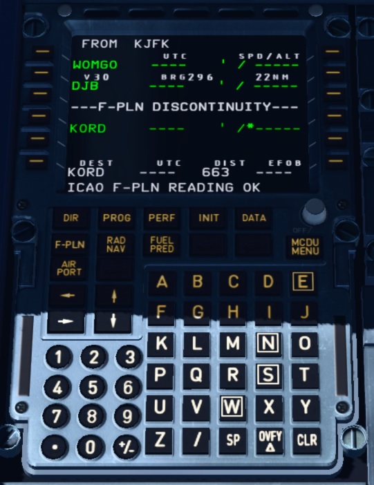

To Ilankrt
Your flight plan works for me ...

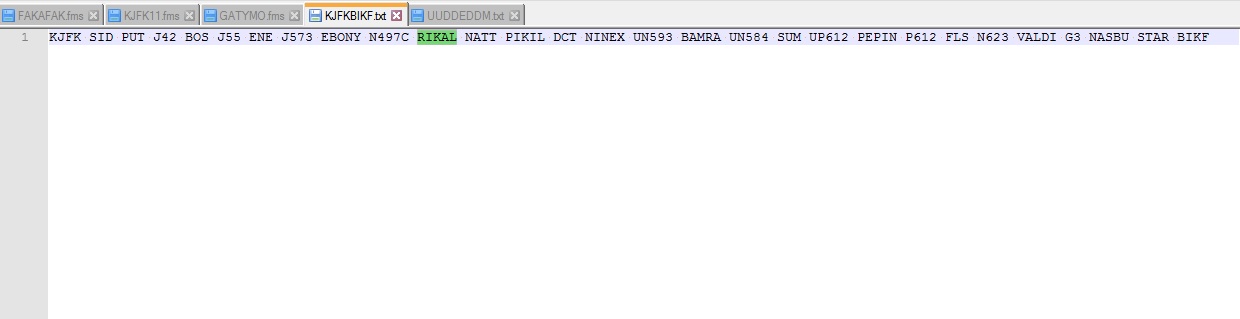

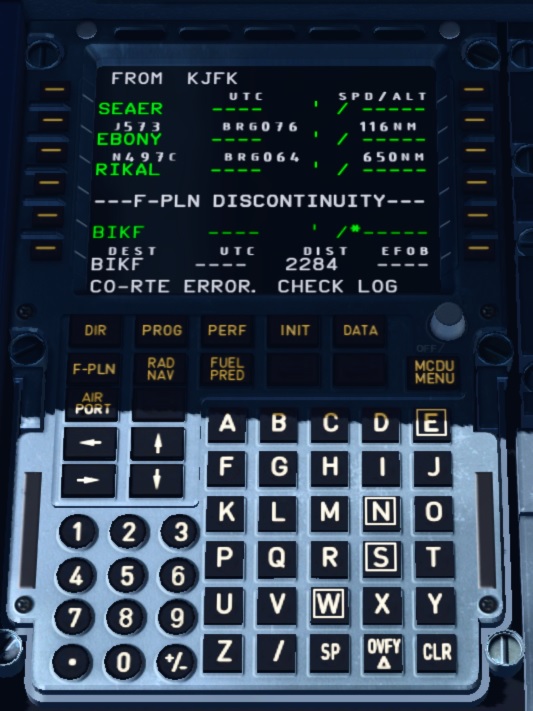

Try:
KJFK SID PUT J42 BOS J55 ENE J573 EBONY N497C RIKAL NATT PIKIL DCT NINEX UN593 BAMRA UN584 SUM UP612 PEPIN P612 FLS N623 VALDI G3 NASBU STAR BIKF
Hi! Thanks for the idea, but the result is not good. See attached pics.

Here is the fp :
It's ok. SID is missing, but that's not an issue.
See pic.
Thanks! But this won't work with every route sad
434 (edited by Yoss 2017-03-27 22:14:45)
I guess, the problem is with the length of the FP. I am not sure about this, just suspicious as there is no difference in the formats.

About nonworked flightplans - please read Error message at MCDU and lool into log.txt to understand what leg was wrong.
