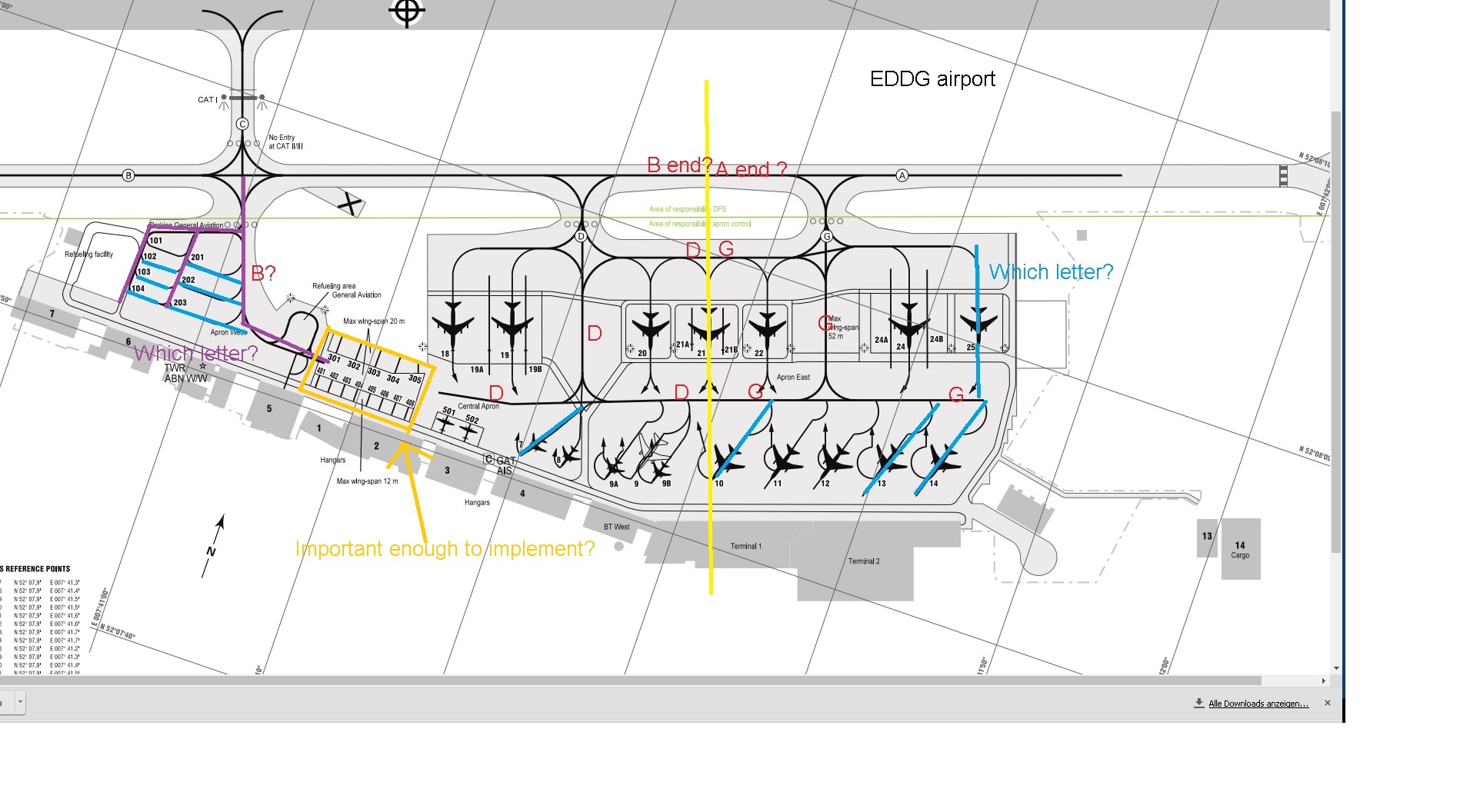

Question 1./ Take a look at the following screenshot.
http://jardesign.org/forum/img/m/22/t/p … 0137g3.jpg
Its from post #2 the order :
.Place "aircraft" symbol (parking position) where Nose of aircraft should be.
Use "doubleway" taxiline for taxi In-pushOut stands/Gates
I am not sure, what this sentences means now. Do i need a park position for
14R and 14L or not? I think, i need only 1 park position for alle 3 park positions.
Correct?
Question 2./
Take a look at the attachment #1. I am not sure, which letters i should set for some taxiways.
And which letter/character i should take for a gate or ramp?

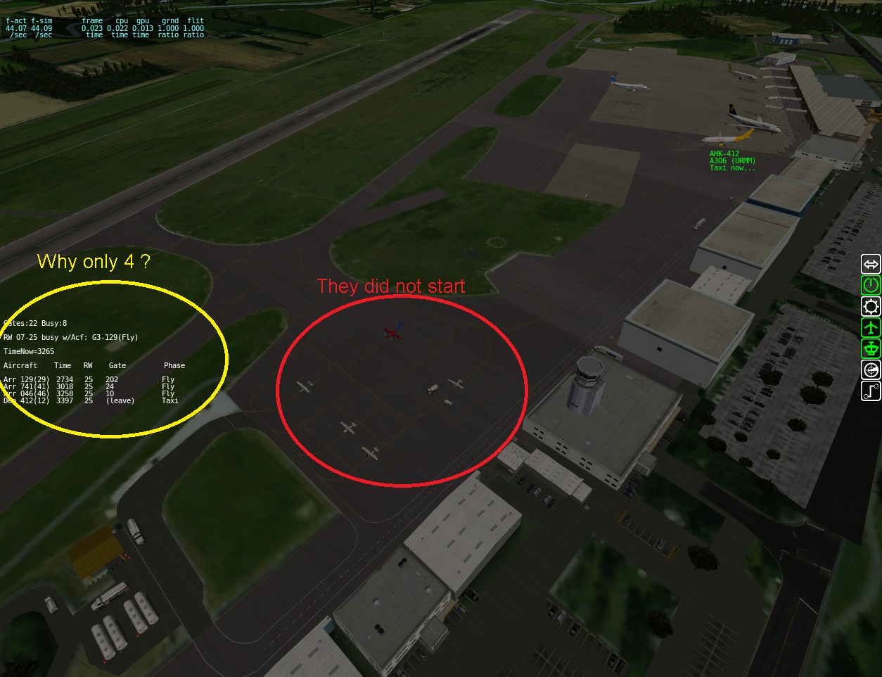

At have 7 parking slots at the General Aviation area. But the planes there dont
start. Only if an aircraft land, it will park there. In some rarly exception, there
start a C172. Do prefer the x-life plugin only big aircrafts?
Question 4./ At the EDDG airport, i have only 4 active aircrafts at all time. The
airport EDDH has 6. How i can control this number?
Thanks for some answers.

Re: How to Create ATC-taxiroutes using WED. Rules, features.
1. Park position will work with all runways.
2. End of B in the place where it cross C. I think you need find a better charts. Also, you should check where airport signs placed, cause a lot of users not use FMCar, but prefer look at airport signs.
3. Need to see picture at WED of this place to understand what wrong
4. Depend of active independent runways.

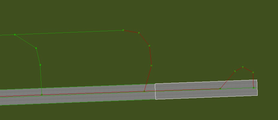

i have some questions for a new ATC taxiroute apt file
I want to create EDDW.dat for x-life.
I used this chart.
http://nav.vatsim-germany.org/files/edw … DW_GND.pdf
You see there a pocket turn at 09 and 27 and i implemented it like the following description
http://jardesign.org/forum/viewtopic.php?id=1670
http://jardesign.org/forum/img/m/22/t/p … k1pcfj.jpg
My problem is the following.
Question 1./
All aircrafts type from a cessna 172 to B747 or A380 use now this
pocket. For a A380 its okay, because the runway is to short for this
aircraft. But a Cessna could start without the pocket.
Is there a logic implemented inside x-life, which consider this fact?
If yes, what do i wrong? If no, i would delete this pocket because small
aircraft should not use it.
You can finde the WED File at attachment, if you want to take a look.
Question 2./
The holding point for runway 09 is not directly at the runway. I need 3
extra nodes. I think, i have read an information in the past, that these
3 nodes have to be declared as runway at the taxiway. I tried this, but it did not work.
Check the WED File in the attachment.
What do i wrong?

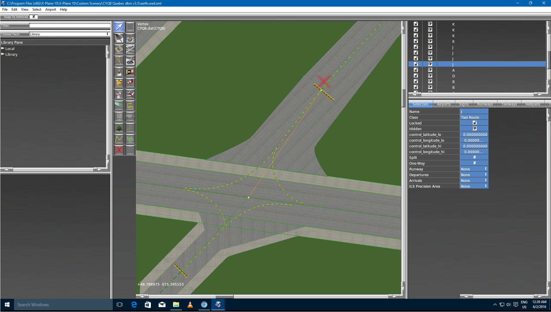

EDIT: After watching traffic for a few minutes I saw a small issue, I uploaded an image.
The red X is where the traffic stops at the holding point and takes about 5 minutes to keep going even though there's no plane landing on this runway but on the other one which has nothing to do with this taxiway.

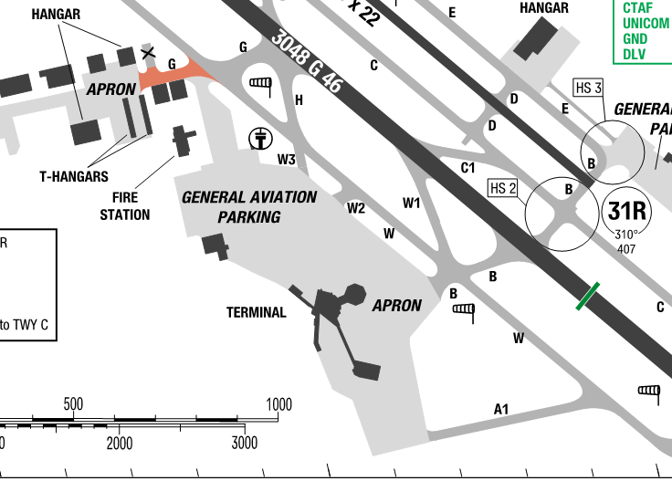

What should I name a taxiline on the apron that is not labled?   as you can see on the chart...it is not labled but there are taxilines that connect the taxiways and the gates just not lettered
Joshloar10: Have a look around for the chart for the apron. There should be a chart that defines where the gates are on the apron and most likely the taxiways on the apron (and General Aviation).

i have this message:
"Route node C_stop is within the runway's bounds but is not connected to the runway's taxiroute"
when i want export apt.dat with WED 1.5
Essentially when i make a pocket. It seem WED 1.5 don't accept the ATC's runway points when they are not exactly on the runway.

6.Place "aircraft" symbol (parking position) where Nose of aircraft should be. Use "doubleway" taxiline for taxiIn-pushOut stands/Gates
http://jardesign.org/forum/img/m/22/t/p1a9nmuv9210kn1hkd1u1fg0137g3.jpg
7.For TaxiIn-TaxiOut stands, Use "oneway" taxiline as Enter, Place Park position at the end, leave some space (2-3 m), draw "oneway" exit taxilene.
http://jardesign.org/forum/img/m/22/t/p1a9nn6csm1g2vls0iepmov182eb.jpg
8.Use similar solution for runways with "pocket-like" turn at the end.
http://jardesign.org/forum/img/m/22/t/p1a9nn8dljugq1hagev91ajk1pcfj.jpg
i am having big problems with the turn on the end of the runway sad the planes drive to the end and just turn on the grass and takeoff
WED 1.5 is not supported yet so it's necessary to stick with 1.41 for the time being.
