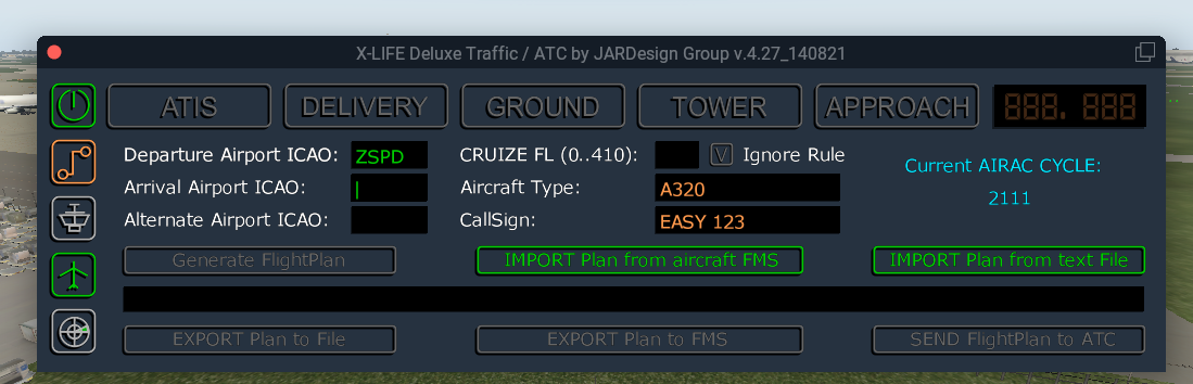

Would like to change the "EASY123" callsign depending on the flight. Seems to be impossible now. is it part of an upcoming update?

Should work. Please note - you may use English letter only. What going wrong exactly, please?

Go to CallSign window with mouse, clik on it, with right arrow key go to the end of callsign, then clean window with backspace key and write "yours callsign".  Little complicated but it works.

I did the method suggested by Darko24 and it works - I suggest you mention this in the user manual as it is not really straightforward. Clicking at the end of the text will not work. Thank you!

Works well thank you so much for the reply!
