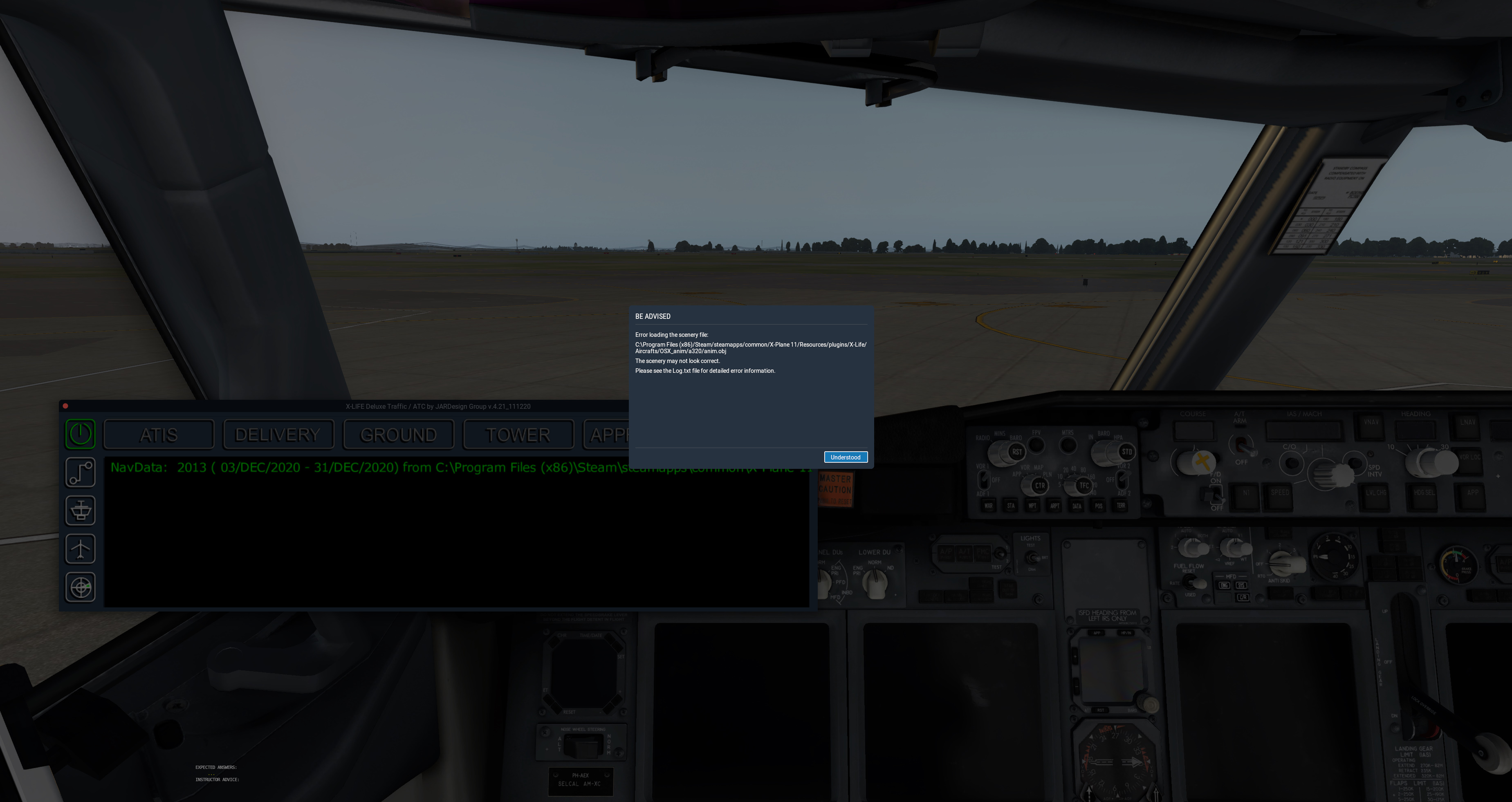

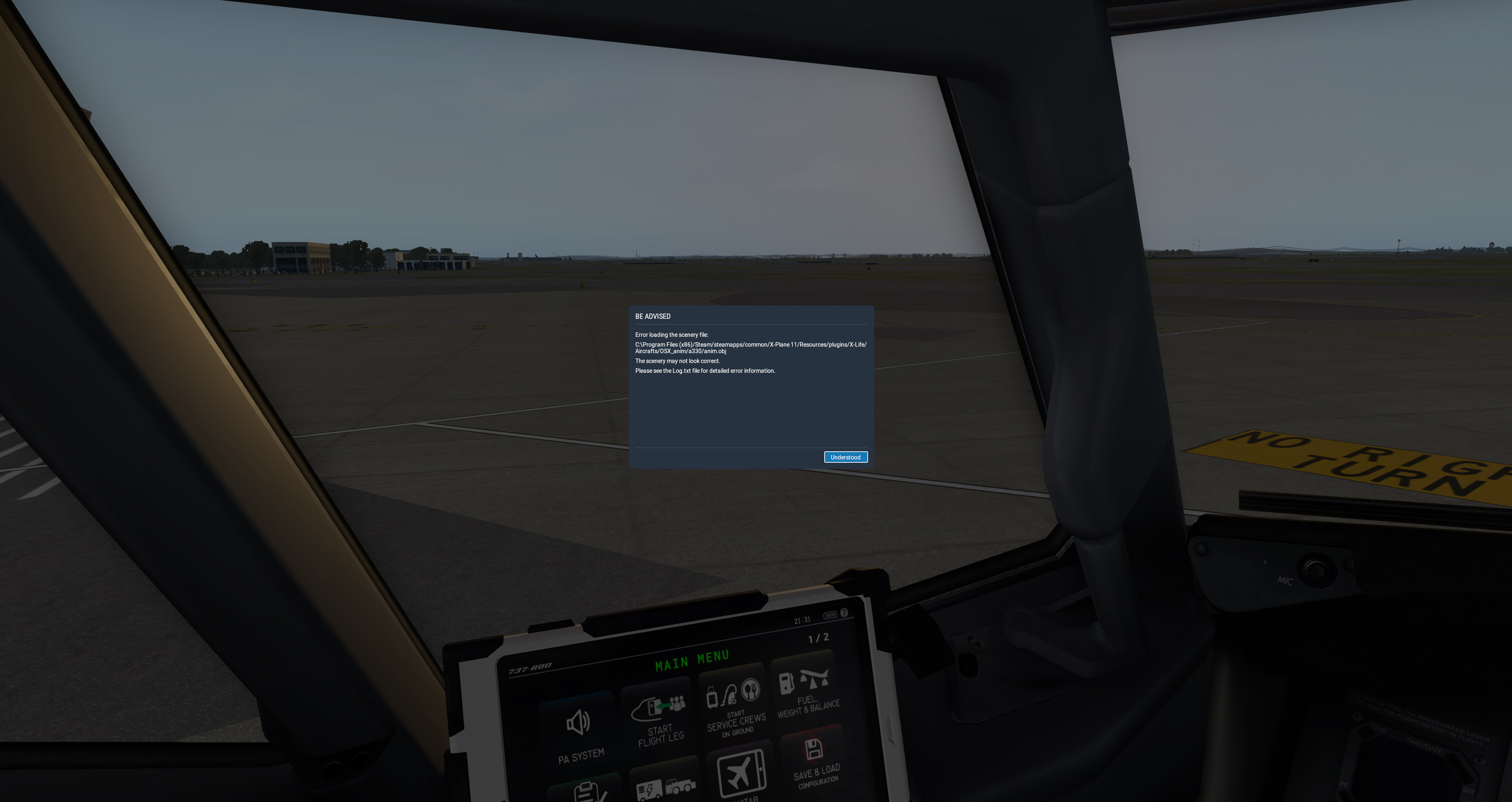

I too have the same loading error as anyone else in xp11.50.  With or without Vulkan.  And no solution in sight.

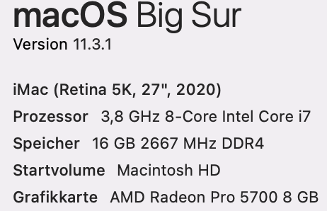

Hello, I have a problem with the integration of X-Life and FM in X-Plane 11.53. Both are copied in the ../X-PLANE/Resources/plugins/ folder. But, when X-Plane 11 is started, they are not included in plugins there (image_1).
FM: Actual version 2.6 for X-Plane 11.41
X-Life: X-Life ver 4 for X-Plane 11
System (imge2)
Thanks for help.
In Log.txt i found this
dlerror:dlopen(/Users/axel/Desktop/X-Plane 11/Resources/plugins/FM/mac.xpl, 6): no suitable image found.  Did find:
    /Users/axel/Desktop/X-Plane 11/Resources/plugins/FM/mac.xpl: code signature in (/Users/axel/Desktop/X-Plane 11/Resources/plugins/FM/mac.xpl) not valid for use in process using Library Validation: library load disallowed by system policy
dlerror:dlopen(/Users/axel/Desktop/X-Plane 11/Resources/plugins/X-Life/mac.xpl, 6): no suitable image found.  Did find:
    /Users/axel/Desktop/X-Plane 11/Resources/plugins/X-Life/mac.xpl: code signature in (/Users/axel/Desktop/X-Plane 11/Resources/plugins/X-Life/mac.xpl) not valid for use in process using Library Validation: library load disallowed by system policy
I think that's the problem.
Here are detailed steps to investigate and fix this issue (from BerlinFlyer56):
1. Open Terminal app
2. type xattr then a space, then drag the .xpl file from Resources/Plugins/(plugin folder) to the window
    press return
3. If the plugin is NOT quarantined, you will see no output in the Terminal window
    Otherwise, type xattr -d com.apple.quarantine then a space, then drag that same .xpl file into the window
4. press return
This should turn off the quarantine flag so you can run the plugin again. Note that this will have to be done for each plugin individually.
